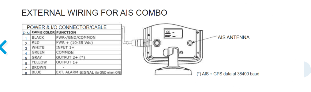

I have an unusual bit of kit, a Digital Yacht Smarterchart 500 which has GPS and AIS receive built in. The external wiring diagram is shown at bottom.

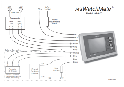

I would like to see if I can connect it to what would be essentially a repeater for the AIS data - a Vesper Watchmate WM670 diagram below:
As seen the AIS repeater is expecting position and AIS data from a conventional transponder. Three questions:
1) Can I just connect up the colours and expect it to work - or is it a complete dead loss?
2) If it is incorrectly wired do I risk ruining either unit?
3) Any suggestions that are more likely to succeed?

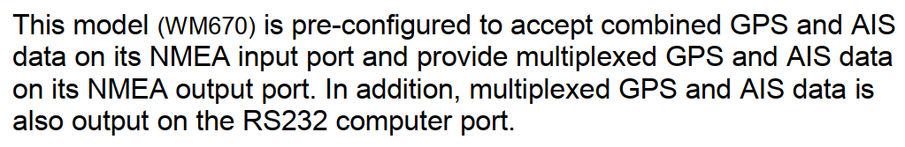

From the manual:

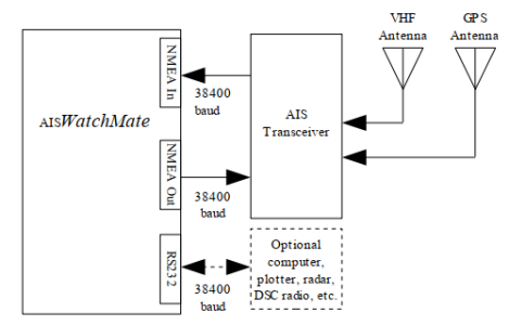

Is the AIS transceiver above a separate box that you can just omit?

From the manual:
View attachment 203363View attachment 203362
Combo grey goes to watchmate green
Combo green goes to watchmate white
Should be no need to worry about baud rates.
Simples.
