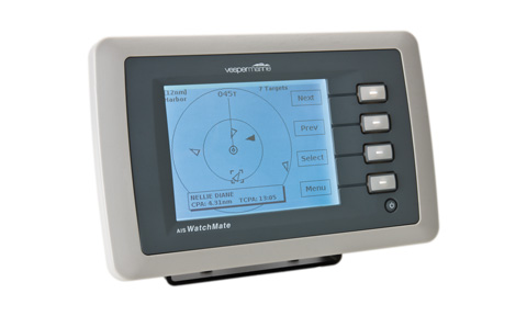

As Supertramp has said, the Vesper Watchmate 850 would have suited you but discontinued long ago. Garmin bought them out so that takes care of the competition from that quarter.
Keep your eyes open and one may come up secondhand, they are very low power devices and have some excellent features. Anything less than £350 - £400 would be a good buy.

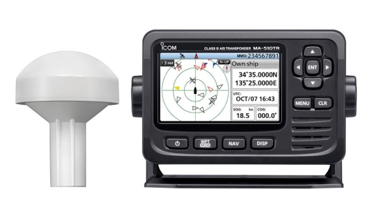

Next the Icom MA510Ta. These have a colour screen and some other handy functions. I saw one the other day in my local Force 4. The bad news is a cost of over £700. Again you may be lucky and find a used one.
