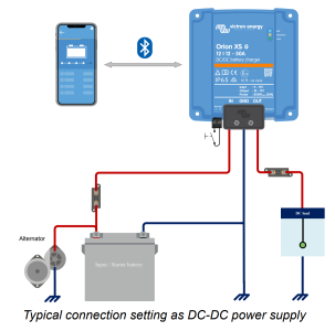

Confused now .................... where would the VSR go .......... immediately after the alternator I guess ??
