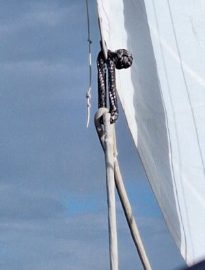

I just set my hank on jib up with this - a thick dyneema soft shackle and spliced ends in the jib sheets. Main reason was to avoid concussion when handling the sail in strong winds! It catches much less. Considering changing my roller genoa to this as well.
Splicing old 14mm rope is a slow battle.
