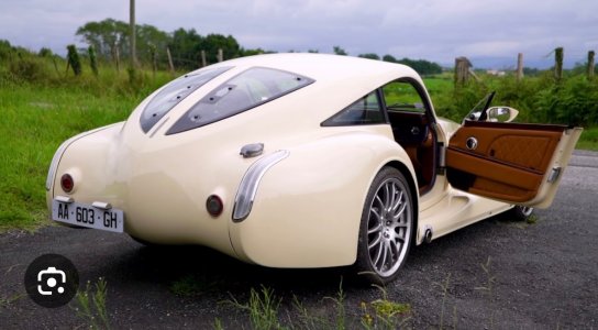

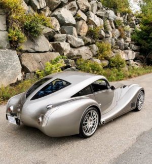

This problem is not unique to the boat building industry. In Morgan’s glorious Aeromax the rear windows were bonded to their hinges. After a couple had blown out at high speed the factory recalled them and mechanical fixings were added. Mind you, when you see it with and without the mechanical fixings why they wanted to go with the bonded ones in the first place.
