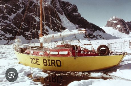

I'm reminded of David Lewis and "Ice Bird" where he covered over his windows after a knockdown. He avoided one problem but acquired many others - brought about by venturing into storms and waters most will never see.
