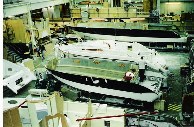

L, I'm not sure it's interesting to start a debate along the lines of "my boat is better than yours".
After all, as we all know, what really matters nowadays is the full beam cabin size, how large its windows are, and so forth.
And neither your nor my boat can compensate the lack of that with a better w/t compartments layout!
Anyhow, since you insist, are you ready to be overwhelmed? Let's start...
The w/t compartments on my DP are as follows, bow to stern:
- anchor locker (if you wish to consider it),
- bow+guests cabins area,
- crew area,
- engine room,
- stern lazarette (with P brackets and rudders placed in that compartment, separate from e/r)
On top of these "internal" areas, there's also a large compartment under the swim platform (Ferretti style), also with its own bilge pump.
I didn't count it before as a w/t compartment, but its volume is probably 5+ times larger than the anchor locker, and much more relevant in terms of flotation reserve due to its position.
Besides, I completely disagree on structural tanks being negligible. Sure, in terms of flotation they are neutral when full, but if the hull bottom is ripped open in the structural tanks area, the worst that can happen is that diesel is spilled in the sea, as opposed to sea water flooding the hull - i.e., the boat flotation would be completely unaffected.
And since the forward structural tank is for water, with a bit of luck the spill might be just of fresh water!
Overall, the volume of these tanks is almost 4 cubic meters, which puts the anchor locker in perspective, I reckon...
All bulkheads are structural, glassed all around, with zero holes anywhere - not even gland sealed.
In fact, any hoses etc. needing to go through the compartments use a rather peculiar (actually unique, afaik) solution of routing them inside the hull stringers.

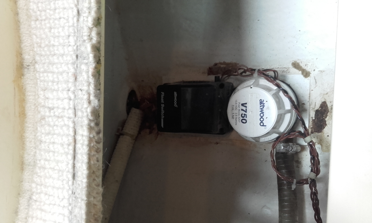

Each of the above compartments has its own electric bilge pump, with the exception of the anchor locker which obviously doesn't have any and the engine room which has two.
These pumps are backed by a large diaphragm pump that can suck from each compartment through a selectable manifold, which can also be connected to the raw water pump of one of the engines (the other one can suck straight from the e/r).
