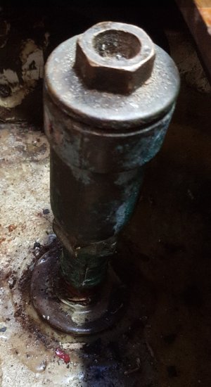

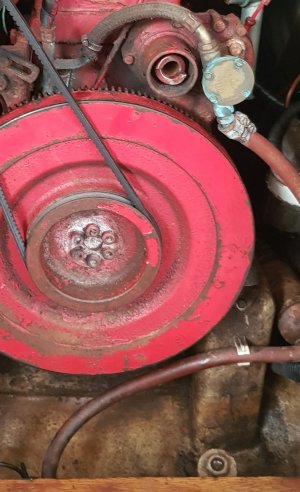

Yesterday, after completing an engine flush on my Bukh I checked my strainer to find it seized. Can I just fit a ball valve with a hose tail to my through hull, then just use a plastic sea strainer. I'm worried if I'm out at sea, and need to check my strainer I might not be able to open it.
I was to replace with this item SEAFLO Raw Cooling Water Intake Strainer for Seawater Marine Boat 1" 1.25" 1.5" | eBay
the 1/2" version I would use.
I actually think my set up is wrong, because when my boat takes to the ground all the water drains out of the engine.

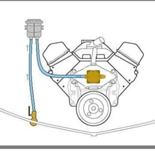

the picture below is how I'm thinking to set the strainer up.

I have a Vetus strainer much as you show. It's much more effective and has a larger capacity than the old type on my previous boat, as well as being easier to get to.
ridgy
26 Jan 2003
1,441
North West
I have just fitted exactly this for the same reason, the old metal one was seized as well as being manky.
I think the instructions say for the bottom to be 6 inches about the waterline or thereabouts which is what I did.
Works great you just have to make sure the lid is on tight otherwise air gets in and not enough water is pulled through.
You can get them cheaper than that though:
Seaflo Sea Water Filter Small 0.5 – 0.75 Inch
Tranona
10 Nov 2007
42,347
Cheaper because the one originally linked to is the larger size.
Much better than the below waterline type (that is why the water runs out when you dry out),
The challenge will be to remove the old one and fit a DZR ball valve and hose tail to the existing skin fitting. Probably best to cut the whole lot out and start again.

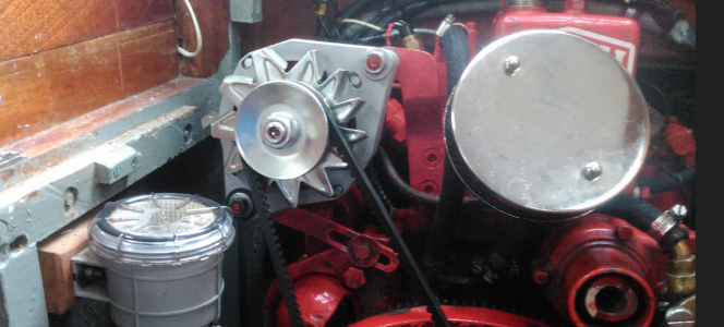

This is what I have for my BUKH DV10ME. The Vetus strainer connects to a Blakes 3/4" seacock.
It works very well, and for flushing the engine through with fresh water I only need to close the seacock, take the lid of the strainer and run fresh water into it.

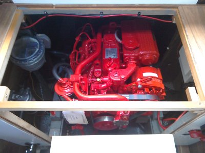

Good. Just replace the strainer with a 1/2" ball valve and hose tail in DZR and mount the strainer immediately above if you can. When you dry out water will drain out of the pipe through the ball valve if left open but the keeps a head of water. It should self prime when water returns. This is my setup
