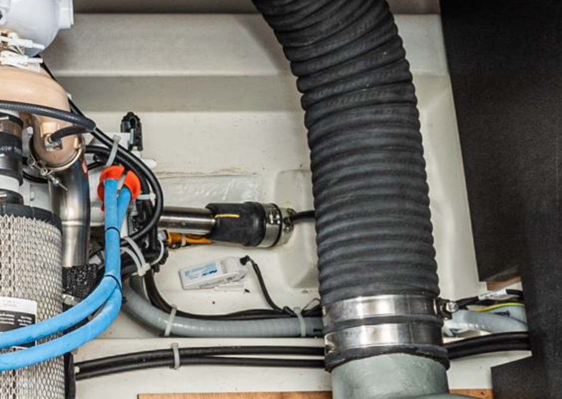

I haven’t got a good hi res photo...I’m not on the boat so I gleaned this off the internet
It’s dripless and appears to have its own water supply...so I know it could be controversial

Yes. Needs a quick squeeze once afloat to make sure water has got up there. also check with whoever serviced it that they squirted some grease into it. You have a positive water feed (the small black tube) so burping is belt and braces. Once you get going water from the engine will feed it

I have exactly the same arrangement, worked out that the pipe from the top of the seal must allow it to vent to fill the tunnel with water but I vent mine anyway.
Pinch with the fingers and just a small amount of air comes out before water starts. I suspect they dont actually need burping!

It’s the same as mine… a quick squeeze when it’s in the water and you will here the air come out with a satisfying pfffzzz… I put in a little bit of the Volvo blue grease in a paper straw - flatten the end and insert under the seal.. best to do that bit while it’s still out of the water though…

I have the same seal. On mine the water supply is from a scoop skin fitting, not pumped. Definitely needs burping. I find i don't have enough finger strength to squeeze but it is so much easier to apply a little sideways pressure to the nose.

Silicone grease will be fine if you have any. You only need 1cc. Just calculate the volume using straw diameter, squeeze in a little more than required, flatten the tip and insert into the seal. Run something flat along the straw for the distance needed to give about 1cc. Don't push the straw too far into the seal. I vaguely recollect about about 1cm under the lip is OK.
Others are correct about burping, the material is quite stiff. I find it's easy enough if you pinch between finger and thumb and lift slightly. This usually deforms the seal enough to release trapped air.

Ok…so the boat went back in the water this morning…I squeezed the rubber seal…not very hard, and it didn’t distort at all…but it let out a satisfying hiss of air and water…so I did it again and it hissed again
So all is good…thanks everyone for your advice 👍🏻👍🏻👍🏻👍🏻
