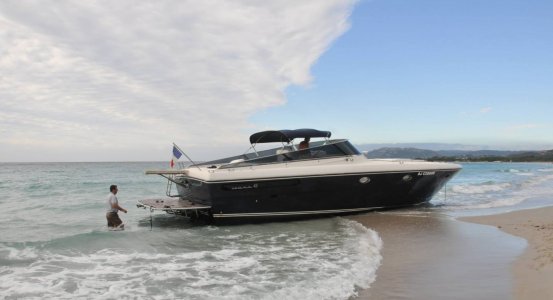

But Had I ran the Boat aground then they would have paid out --- Something I wasnt Prepared to do was cause more Damage and be stranded on the edge of a field.
Hence wanting a T43 with Shafts - I don't want anything to do with the devils fans.
Jon
Just be aware that if you run aground with shafts at speed, a typical scenario is that the P-Bracket is driven upwards through the hull leaving a large hole, and the boat sinks. Or the shaft separates and pulls out, and the boat sinks.
Outdrives will usually kick up, albeit with damage, and the hull usually remains intact, assuming the drive is still attached.

No I'm not, if this is someone running in shallow water where running aground is a risk, then shafts might not be the best option.
Outboards or outdrives have advantages in shallow water.

I dont think he hit that beach at 20 plus plenty knots. More like a greased landing and settling on the tide
