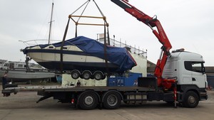

I have sorted a HIAB at £325, cheap as chips that, i have used cranes and HIAB in the past and never been below £550.Going to be checking a few launch areas in the next month or so now.

now, tell me wtf is a HIAB ???
cheers
V.
As above
One of these V
What do you call them over yonder water ?
thanks guys,
I think we call them er, cranes?
:p
or lorry with fitted foldable crane? I'll ask a friend who has a couple of them...
So, you're going to hire a thing like that to pick up your boat from your yard, secure it on it's platform and get it to the water, right?.
You also hire the strops and frame from the guy, right?
So you're going to keep her in the water?
