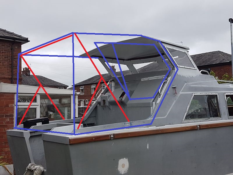

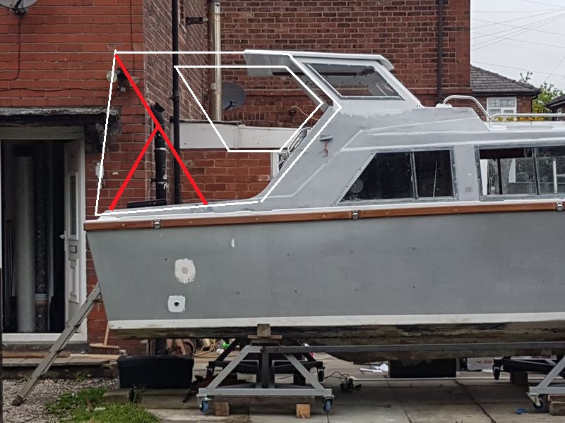

Well I found some pics so I have had a doodle for the canopy design.
Bit rough but its an idea. The frame will be made from 3/4 inch /19mm SS tube i would go bigger but i have a 19mm tube bender. It will be hinged just above the joint ( if I can find a 19mm SS tube hinge ) of the red triangle so then the frame will fall back and then hinge up so as in affect be a seat back rest for the deck seats.
Not set on the entrance door yet but along them lines and be fully removable fro when folding down the canopy.
I hope folk can offer help here as this is the biggest job for me of the complete build and i am actually worried a little about doing it.
I dont want to throw the towel in yet and get it made for me a si like a challenge so bear with ;)
And if anybody knows of a place that does 19mm tube hinges like these please tell.
All i can find is Sheridans
https://www.sheridanmarine.com/product/stainless-steel-canopy-bar-hinges

When the canopy is folded up you have to think of how it will stow and where. Also think about access to the side decks (unless there is a hatch up front) and it needs to be able to lift up a bit over the cleats for rope handling. Ever thought of getting a professional to give you a quote and show you a design?

I am hoping that once the side doors are removed it will all fold down as in last pic. If not then i can arrange storage for the canvas somewhere. Even remove the back section also.

And when it folds down then the side cleats will be clear from the frame. The way its going i may just get a pro to do it yet. Got so much on.
