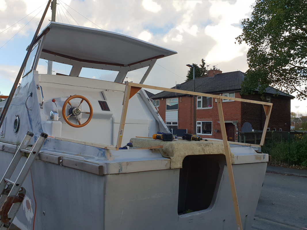

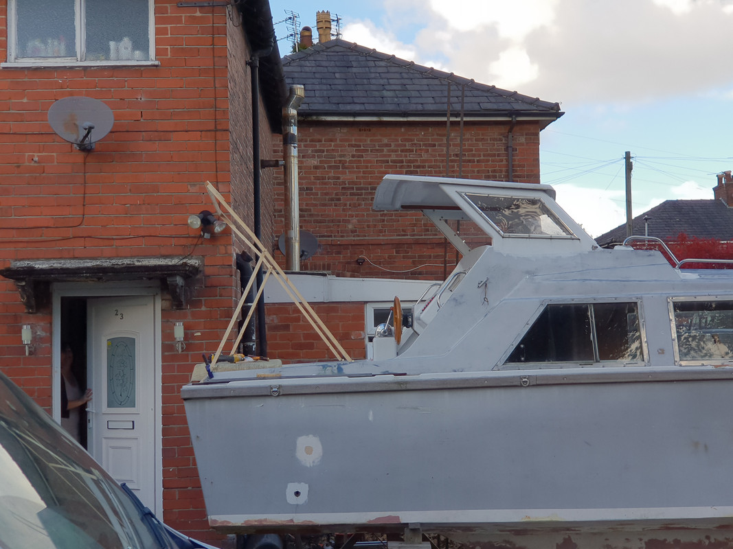

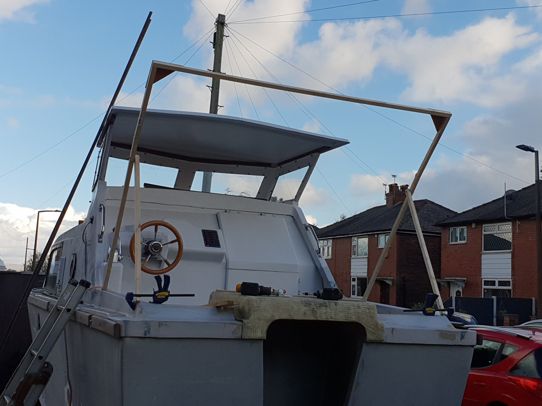

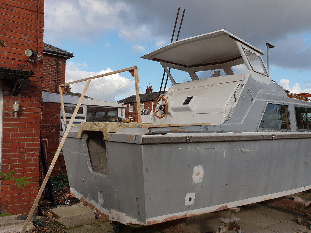

Before we go any further i am not fixed on this design and working on it.
Frame set up
Then folded down
This was the first time but i decided that the back upright is a little to out of proportion and high.
So dropped it by 100mm and looks better and gives a better fall as it will now slope down more to the back.
To fold it all down it will need the sides at least removing then the top folds down as a backrest maybe for the seats. Held up with chains or strap which i think will be better.
I am going to practice all this on the trailer and making a cover for it on a low frame just to see if i can do it first and get a good fit.
Lets see if i can keep motivated for the next few weeks as this week i will get a sheet of 5mm ply and do a bit on the interior and lightweight mosaic tile sheets for the galley. That is what i have decided to do on the galley unit as after thoughts it will hopefully look good and easier than laminating over the ply base it has at the minute in one sheet. Just being picky but i dont like the idea of laminating the unit in a few sections.
So any thoughts on the canopy frame please tell ;)
Looks good (I still feel bad for daring you to make the hood:(). Just a llittle word of caution that I’m sure you know about. When an outboard is moving fast, the exhaust gases are through the hub underwater but at idle and I think slow speed, the gases come out of the engine housing. If there is a gap at the back of the hood the wind could blow gas into the hood and the people inside. Like I say, I’m sure you know this:)
Dont feel bad matey, just imagine if it works out and how happy you will feel then :) You cant feel any worse than me and when i got it home a few years ago. OK maybe a bit longer than a few years.
On the outboard fumes, yes aware. The canopy will go over the engine lid forward of the edge by a few inchs and pined down. Although i am thinking on have the engines lid rear section sealed down fully as in bonded into the transom and the front section hinged for access and sealed with EPDM D section.
That should keep all gasses from the engine out of the deck area.

Hey Wayne,
Somehow I've had two senior moments in quick succession, having written and deleted two posts! Anyway, here goes again. I was curious to know if you'd intend to use the boat with the canopy/cover in place, and if so, be aware of your headroom if you opt for the lower setting on your top section. Just a thought.
Regarding the fishing, I intend to set out further afield after the cod to be found at Derrynane. This means a 60 mile round trip from Kenmare, right down the bay and out into the "open sea" though still very coastal.
I suggested the turn buckle fasteners as I'm finding that my snap/stud fasteners are getting very tight, but a little lube or graphite should help this.
I don't know if you got my mention of having the canopy material overlapping the boat, either inside or outside with consideration given to avoiding having rain or spray being driven in under the canopy, making it's way inside. I'm sure you know what I mean.
And don't be afraid to sew things up a little slack to start with. It's much easier to tighten up a seam than to expand one. My Bimini was a lot of fitting, marking, sewing, refitting etc. until I got it right. I also covered the tubular frame with pipe insulation which gripped the fabric somewhat and helped things to stay tight. The attached pic shows the top still under construction. Bimini 2.jpg Anyway, keep up the great work.

Hi there
I was going to go with the idea as you mention of having the upright as is in the picture being able to slide down the lower section so then the cross bar can lay flat on the engine cover.. Only problem, being a small ones, first is a tube size for one to slide over the other with little play and the other is finding a good fitting to do this task without using clamp screws etc. Spring buttons could work.
Hi there
W,
I doubt you can find tubes that would slide one in another, and if you would, the larger one would make a mess and score v.badly and v.quickly the smaller one!
I tried to design something like that for my aft deck, once you'd do it properly with an ertalon piece to slide through, sizes were way too bulky and ugly, so dropped the idea all together.
I'd try and design it in a way that you have parts pivoting out of the way, not easy I agree, but I think doable.
