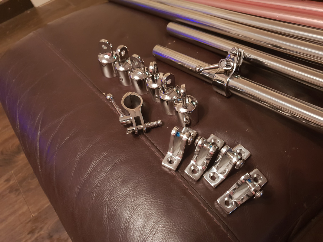

Just done a quick work out on fittings and looked at using 25mm for top hoop and 22mm for the rest with the 22mm clamp so then slide the 25mm hoop up the 22mm and clamp up. The clamp will either be free running up and down the 22mm when loosened or i can weld the clamp to the bottom of the 25mm tube legs, only on one half of the clamp though obviously..
Just wondering now if these corners wll be ok for the top hoop,i was going to get some 100mm radius pre formed tube and weld it all up to make the hoop.
Thinking a bigger radius will be better for the job ?
https://www.seascrew.com/browse.cfm?25MM-BOAT-RAIL-STAINLESS-TUBE-FITTINGS&p=0000001581
Just putting this here so i know where to find it.
2 x 22mm 90º Corner.. Stainless 316 Rail Fitting
6 x 22mm End Eye. Stainless 316 Rail Fitting
2 x 1 Metre Length Stainless 316 Tube 22mm Ø x 1.2 mm Thick.
2 x 1 Metre Length 25mm Polished 316 Stainless Tube
2 x 22mm Slide Clamp Fork. Stainless 316 Rail Fitting
2 x Base Mountted Ear. Tube Fitting. Stainless 316 Rail Fitting
1 x 1.5 Metre Length 25mm Polished 316 Stainless Tube
2 x 1.5 Metre Length Stainless 316 Tube 22mm Ø x 1.2 mm Thick.

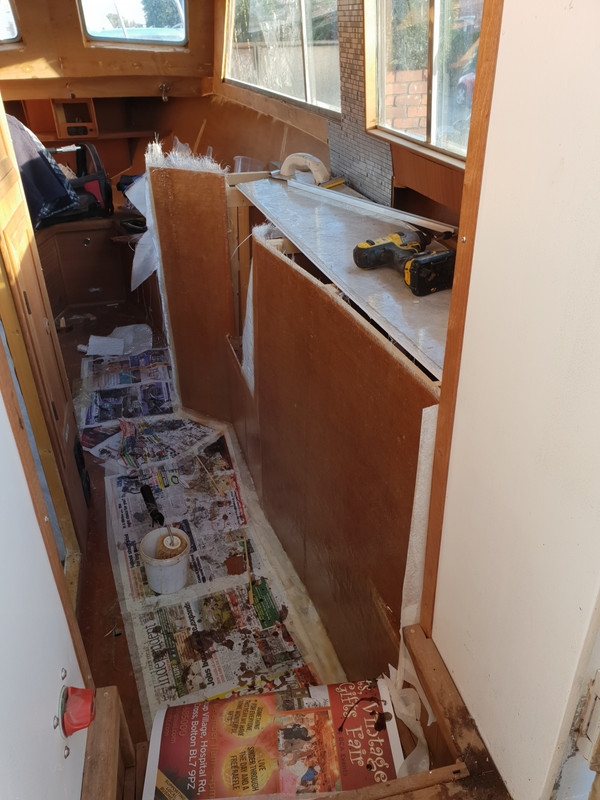

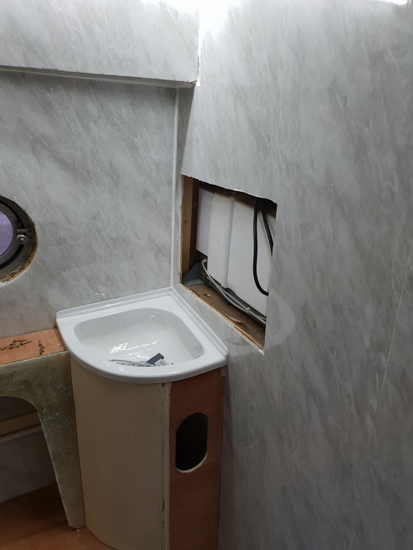

This weekend I managed to laminate the galley front so ready for the top laminate when i choose the colour, not wood as there is enough I am thinking a deep gloss cream type. Just a 650grm combo and topped of with i think a 250grm woven with a 5mm ply backing, should keep the curve and shape nicely. . I started trimming with ally U channel around the inspection covers in the heads and was going to finish them off today but other stuff got in the way. still at least i got motivated hey.
Looking at that its a bloody shamefull work.
Ah well.
The laminated panel will be removed as i fitted blocks to the back for easy removal and in places with no rear access i used small screws through the ply so it can be ripped/pried off so then i can laminate the panel. It will be difficult to do while in situ as contact adhesive is good but once on its on.
If i have the energy this week i will finish the inspection hatchs and think the best way to cover up the the dam daft mistake i did by putting the hammer through the PVC cladding, a towel hook or something.
Bit by bit.

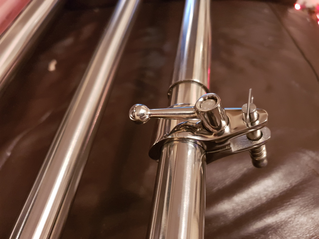

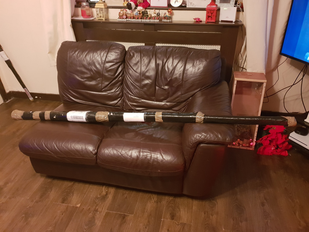

Got home tonight and some of the canopy has arrived. I used Seascrew in the UK for the bits for the frame. This is the first in a while i have bought something for the boat and feel good, although the price and what i am looking does not not look much for the money, hey but thats project boating :)
I will be ordering the Top Gun this week with all the rest of the fittings from Point north and Kyospruce.*
So top frame hoop is 25mm OD and that slides nicely ( 1.2mm wall ) over the lower frame legs of 22mmOD with a a pair of 22mm tube clamps to slide up the top hoop into position.
It is a lovely fit Vas if you read this ;)
I have ordered a pair of preformed mandrel bent 25 OD tubes and should be here this week. I will weld these up for the hoop corners.
good sliding fit
