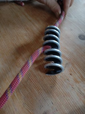

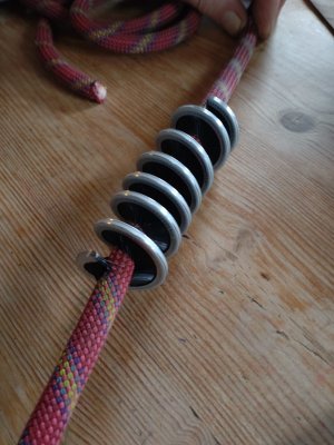

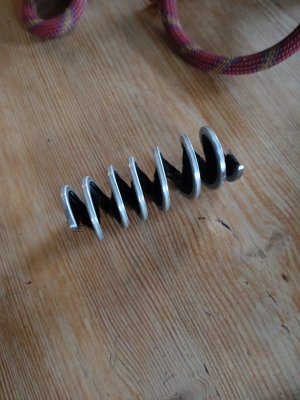

Out son showed me a brush that he used to clean his climbing ropes. This was done in the bath with Techwash Rope Cleaner.
ROPE BRUSH
I am going to try it on the green slime covered ones on the boat.
I will let you know if it worksIMG-20240425-WA0002.jpgIMG-20240425-WA0002.jpgIMG-20240425-WA0001.jpg
ROPE BRUSH
I will let you know if it worksView attachment 176004View attachment 176004View attachment 176005
They come 'rope sized' (primarily rock climbing ropes) - I had thought that if they made them a bit bigger and a lot more robust they could be used 'in line' to clean mud off anchor chain. However my idea was a non starter as I did look but never found anything suitable. There does not appear to be a market for chain cleaners (apart from a deck wash).

I have used a Beal rope cleaner for a few years now. They work brilliantly. I typically fill two 40L flexible builders buckets with water and transfer the rope from one to the other and back again a few times. I find they work even better if you keep the brush submerged when pulling the rope through.
