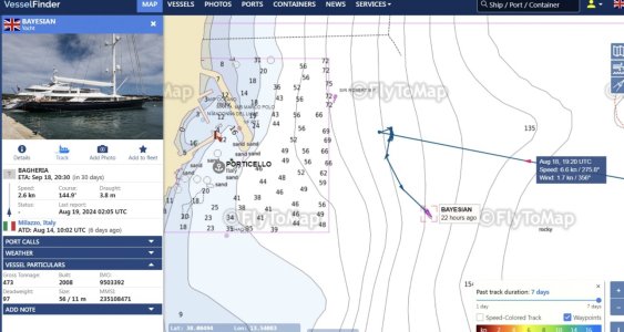

This Marinetraffic screen shot is interesting. You can see her coming up from the east, anchoring, dropping back and sitting like a duck in a westerly wind, and then dragging off to the southeast before transmissions ceased.
I reckon that with all that windage frd of midships - three furled headsails plus the mast - her head fell off as she dragged and she presented her beam to the wind.mtraff.jpg
I reckon that with all that windage frd of midships - three furled headsails plus the mast - her head fell off as she dragged and she presented her beam to the wind.View attachment 181865
Your AIS track confirms what I thought I recalled from the track I saw on the day - the references to keel being up having been into the port seem to be wrong? Hadn’t (yet) entered the port, but arrived from elsewhere and anchored
