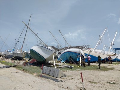

I'm asking this in relation to the recovery of my boat which fell over during hurricane Beryl.
Can a travel hoist lift and lower each side independently? I am assuming they can, to at least a limited degree, to account for any gradient in the yard and to get boats exactly level.
Would it be reasonable to expect a yard to be able to use its travel hoist to lift and right a fin keel yacht?
Things are starting to get a bit ugly with relations between the boat owners, the yard, and the salvage contractor, so it would be nice to get some objective input on what's technically feasible.

The boat was positioned where it is by this same hoist, and no other boats were subsequently placed nearby.

In my particular case, these problems do not apply. No mast, no nearby boats, and the hoist is rated to lift over seventeen times the weight of my boat.
