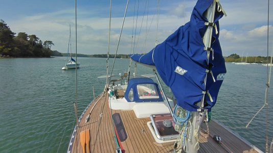

Got to be honest, I’ve not seen a synthetic teak that I like. But everyone has their own taste.
This is what my previous boat's cork based 'faux teak' looked like in 2021 as I helped her new owner sail the boat back to the UK.
This was 12 years after the deck was fitted.
If I had to re-do the teak deck of my current boat, I would use the same thing again.
