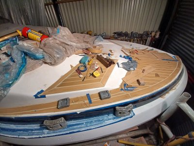

The bond between the hull and deck has failed in several places.
The deck was bonded to the hull flange with some sort of ridged sealant, with 16 years of sailing and the hull and deck flexing, the sealant has gone brittle and is allowing water to seep through.

Thanks Goldie.
The fact that they are described as a sealant removal tool is encouraging.
I had originally discounted a multi tool as being too difficult to control based on my experience with a Ryobi multi tool, which I find hard to start without it bouncing all over the place. I guess that the Fien is a more refined tool that is easier to control.
The power chisel looks inherently better, beause the vibration is axial not lateral, and I hope not to destroy the teak planks.
At the moment I can't see a small enough chisel (6mm wide max) to work with the Arbortech Power Chisel, but I'm working on that.
Have you considered chiseling out and replacing the most outboard teak plank only?
Seems that could create space to make good the leaks between hull flange and subdeck, then replace with new teak?
Sacrificing the first plank is definitely an option and if I make a mess of taking the sealant out of the joint between the first plank and the bulwark, that's the way I'd go.
You could always grind the width of the supplied chisel narrower
I had to remove some Sikaflex from a decking and I got a 3 mm wide wood chisel and I modified a onld hand router bit from 6 mm wide to 4 mm by grinding the sides to the required size
