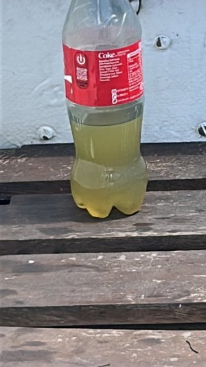

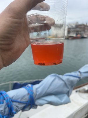

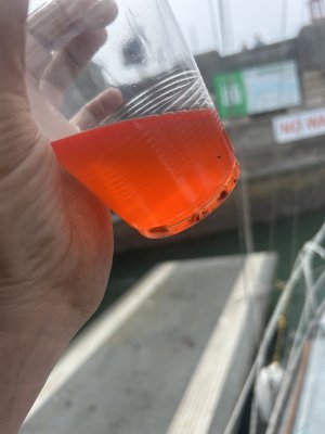

Ok folks…. Diesel
Man said to chuck in my yellow diesel…. Looks a bit iffy to me…. Now have starting problems…. As with my other post of lack of compression but boat appears to have compression again…. Naff diesel?

If its Kerosene - which I doubt - it won't hurt the engine at all ..

Agreed that 'straight Kero' has lack of lubricity but if thrown into a tank with diesel in already - its a point that is negated.
Anyway - looking at the photo - as I said before - it looks like Cloudy Diesel ... possibly summer diesel that was left over winter .. parafins dropped out and not dissolved back ... this would lead to poor starting as the parafins will clog filters ..
Remedy ? Dose of Kero or Gasoline to break up the parafins ...
15 litres of iffy diesel into 20 litres of clean…What quantity have you put into what quantity of diesel?
