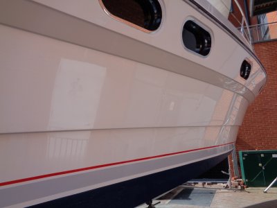

Better with IMO.I'm not bothered really .. but feel that it invites grimey look and stains ?
I have time to decide .. so far I've said I'm not fussed and really want the hull sanded and repainted .... which led to the suggestion.
Go on ... Yes or No ??

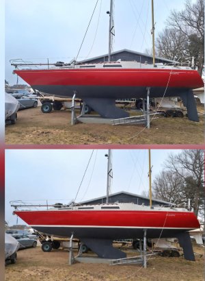

Yes. But to do a proper job the stripe should be wider/higher at the ends, particularly the stern on your hull shape, otherwise, when viewed from a higher position than in your photo, the ends will appear narrower.I'm not bothered really .. but feel that it invites grimey look and stains ?
Basically all replies are what crossed my mind ... yes I like it .. but stains etc after a month or so etc etc.
It does add to the sleak look ashore ... and the line will be above the water by about 1 - 1.5" ... but ... is it really worth it ?
The HORRORYes. But to do a proper job the stripe should be wider/higher at the ends, particularly the stern on your hull shape, otherwise, when viewed from a higher position than in your photo, the ends will appear narrower.
If it's worth doing...The HORROR
I do mine (as built) with seajet Emperor white. This antifouling stays white, well as white as can be reasonably expected.I would add it as I think it makes the boat look nicer. One of the main purposes of a boot top line was to apply a hard antifouling so that the water line did not get fouled when using ablating antifoul below the water line. For that reason, I would use the opportunity to have a boot top line put in and then paint with a white, hard antifouling.
A "Yes" from me.
