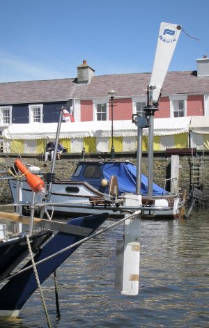

The Navik worked perfectly on the aft slung rudder of my Invicta 26, it needed a couple of lengthened stays.
When I fitted it there were only a few wind vanes that worked with the aft slung rudder, and the Navik was also much lighter and smaller than many of the other options as it was designed for the smaller boat. Although it sounds as if Poignards 'Monitor' would work.
It's a real shame that it's no longer in production and finding a replacement is a bit like searching for an honest politician.
