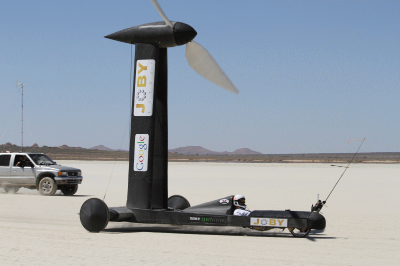

The most common mistake people make is in assuming that power is transmitted from the airscrew (propeller) to the wheels, when in fact the power is transmitted from the wheels to the propeller. In other words, on the Blackbird (for example) the propeller is pulling the car along, not pushing it.

Then please explain the physics rather than making a dogmatic reply like that. How can "wheels power the propellor" That is a contradiction in terms. A wheel can transmit or obtain energy to drive apropellor, but were does that energy come from? You'd have to tow the vehicle to do that.
Where does the energy come from when close to the point of vehicle speed = wind speed? With no relative wind there can be no energy to harvest. You boat doesn't sail in zero wind! Neither can any other vehicle. And you can't claim that a water turbine (analogy for wheels) could transmit energy to accelerate it by means of a propellor either, can you?
Or maybe you can, please, an explanation!
I know it sounds counterintuitive but that's how it works. To summarise: power from the wheels (I'll come back to that) drives the propeller round. By pushing air backwards, the propeller generates thrust, just like propeller of an aircraft. That thrust moves the vehicle forward and provides the power which the wheels harvested (told you I'd come back to that).
At which point, people think "Wait a minute. There must be inefficiencies in the system. How can energy from the wheels generate the thrust which produces energy at the wheels?" And in still air, they'd be dead right - it would be a perpetual motion machine.
But this isn't still air, and the added thrust from the tailwind is what makes it work. It means that the wind does more work on the propeller than the propeller does on its slipstream and that excess is what accelerates the cart and drives the wheels.
Energy is harvested from the relative velocity of the wind and the land. At the point where vehicle speed = wind speed the propeller is spinning away and pushing back against the wind.
Anyway, it has been done.
How many people have claimed to have built a perpetual motion machine?
If the cart goes faster than the wind surely it experiences a headwind not a tailwind?

It's definitely the wheels powering the propeller. The kinetic energy to power the propeller comes from the motion of the cart/yacht. the cart/yacht will accelerate as long as the forward force created by the propeller exceeds the total drag of (1) headwind resistance on the static parts of the chassis (2) friction within the drive system (3) rolling resistance of the wheels.
As far as I know, these machines are land based but I guess that one could be built around a boat. However, it would not have sails but would have a huge propeller where the sails would be.
There's no theoretical reason this couldn't work on a boat, only practical efficiency losses. The problem you have is that the (1) capturing energy from an impeller is less efficient than capturing energy from spinning roadwheels and (2) the water resistance on the static parts of the hull is significant, particularly as soon as you have waves to overtake.
So you could build such a watercraft; it would accelerate downwind from stationary up to a certain speed, but increasing drag would soon catch up with the increasing thrust. Until somebody designs a much more efficient impeller and a much lower-drag hull, that equilibrium point will be below the true wind speed.
Yup, but the slipstream of the propeller goes faster than the land speed of the cart and so experiences a tail wind, which is what pushes the whole thing along.
