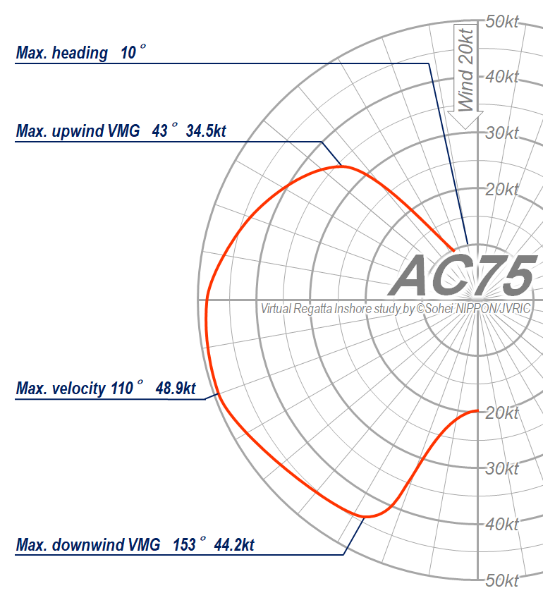

Flaming, the VMG is at 153 off the wind and 44.2 knots but the actual VMG DDW is 39.4. Still somewhat in excess of of the wind speed!
That's fair enough, it's giving velocity at that angle and noting that that is the course for max vmg. Perfectly reasonable to leave it to the reader to work out the actual VMG DDW.

Yes, I can't reconcile that with the Polars you found, but it's not really something that can be mistaken. The weight of the wind is on the port side. Bearing away would take it further downwind, not upwind.
QED.
How we reconcile that with the Polars and the distance time calculation I don't know, but it's unmistakable.
EDIT:
FWIW the polar I posted for AC75 yesterday from SA:
Maybe Pyro can explain his as well, I'm still not clear on that.

I dont really see what there is to explain. The polars say it all, as you mentioned earlier. Your own polar shows a VMG downwind of around 36 knots in 20 knots of wind.
You seems to be forgetting that once they are doing that speed and gybe, they will be exceeding the true wind speed as they turn and the apparent wind is dead ahead during the gybe. The polars and the footage all agree with each other. That's it.
