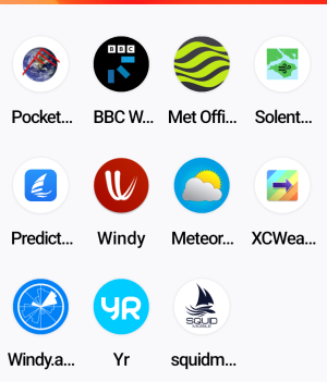

After not paying for years and dabbling with all of them, I am considering a subscription to PredictWind. I like the comparison graphs between the models, however there weather routing is not cheap.
I am curious about the weather routing have tried SavyNavvy but found it lumpy and difficult. When it did work I appreciated it as a guide.
At the end of the day I am old fashioned and the shipping forecast still rules. It’s just the finer points are good to have and can give options you hadn’t thought of.
