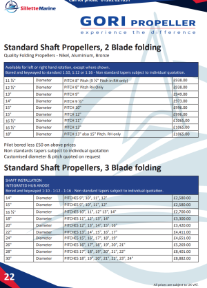

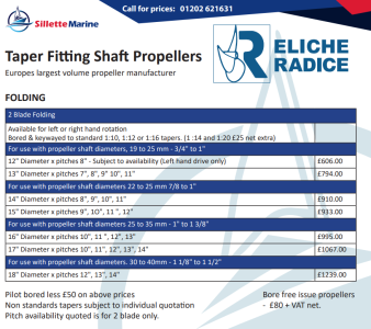

These are all really old posts. I tried to find the mentioned Lansing Equipoise prop but found nothing. Radice and Gori still available through silette and really not that pricey new but sadly it's only the 2 blade props that are in the budget
