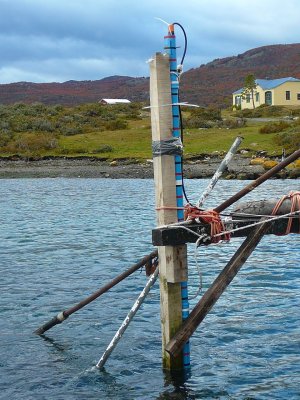

They were using 'tide sticks' in the very early 1800's in Bass Strait - which is when Surprise Bay at the southern tip of King Island was chosen -
through until post WW 2 when the RAN hydrographic department was using 'Bathurst ' class minesweepers as survey ships. A friend was once deposited on a remote island somewhere as radio man for the 'stick readers' for an indeterminate time in the early '50s.
These days the tide sticks are fancier, this is one at Puerto Navarino, southern Chile, in 2009.

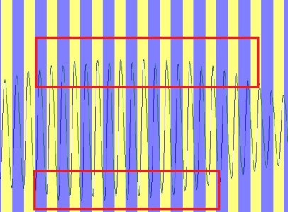

The amplitude of the tidal curve increases towards springs and decreases towards neaps. The envelope of the curve has a maximum at springs and a minimum at neaps. My question about the time of springs is therefore about the time of the maximum of the envelope.
The shape of the tidal curve at a particular place is well known - it is used to produce the tide tables with which we are familiar. The shape of the envelope must therefore be well known, and so it must be possible to produce a table which shows the date and time of springs and neaps at that place. Does anyone know a source of such tables?
Where would you draw the upper/lower envelope?
Outside the highest HWs and the lowest LWs?
Least square errors interpolation between all HWs and between all LWs?

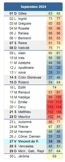

If you remember some earlier threads about tidal coefficients :) a higher HW (or lower LW) does not necessarily mean necessarily a higher coefficient (IOW it does not imply a higher amplitude), the HW level can increase while the amplitude decreases (tide becomes less "springy")--> the "all-outside" envelope maxima and minima will not necessarily correspond to actual spring or neaps times.
That is for mathematicians to decide, and I assume that some must have done so. What I am interested in is where I can find data on the times of springs, based on such envelopes.

'Before tides for a particular location can be predicted, a series of observed hourly heights, preferably of twelve months duration, are mathematically analysed. This analysis separates the observed tide into its astronomically forced components, known as harmonic constituents or harmonic constants, and is represented by amplitudes and phases. Once this has been done, tides can be predicted for any time in the future or past. An analysis for this machine resolved up to 42 constituents. A modern analysis frequently resolves 120 or more constituents.'
These days, a lot of observations are done by satellites, which can probably measure that framework moving up and down.

All those references are informative, but they do not answer my question of when exactly is a spring tide. In order to measure the age of the tide at a location (i.e. the interval between full/new moon and spring tide at that location), it is necessary to know the time of spring tide at that location. How is this defined? If it is defined as the time of the highest high tide, which tide is chosen when (as often happens) there is more than one successive high tide of the same height? This suggests that it is more likely to be defined as the maximum of the envelope of the tidal curve at that location, which is not necessarily at the same time as a particular high tide.
Spring/Neaps are related to amplitude, not levels of single HW or LW. A time series of amplitudes is not a continuous line, giving a local maximum/minimum which you could choose to get your istantaneous hh:mm "time" of springs, it's more like a bar chart with the bars spanning from every LW to HW to LW etc.
You cannot take the outside envelope of the tidal curve as that would be tangent to the local highest HW and the lowest LW -possibly a curved interpolation would yield even higher levels- giving much higher amplitudes than the actual ones. Wrong curve, wrong position, wrong "exact" time inferred.
You drive 500km from 0800h to 1400h, what is the istantaneous, hh:mm time of your 500km trip?
If there was only the moon (let's stick to purely semidiurnal tides)) one might get an astronomical hh:mm time determined by a specific astronomical position of the two, the problem is tidal curves use a lot more harmonics (some >100) many of which have no astronomical relevance, to get amplitudes one must use all these components to compute differences between subsequent max and min : if you find a local maximum or local minimum of this difference you will be in springs or neaps for the entire interval of time. If, as it sometimes happens, one finds the same amplitude during more than one cycle, they will all be springs/neaps, there cannot be an istantaneous hh:mm time somewhere in the middle.
