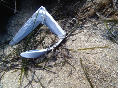

I have found the Lewmar Claw vs. Bruce differences ... just amazing. If you are going to flat out copy something, why do it wrong? The Bruce is pretty good. Very good at some things. The Claw is ... pretty much useless.
These comments are spot on.
A genuine Bruce anchor has some complex twists in the geometry of the flukes (see photo below). Unfortunately, copies are usually simplified designs and these work less well, often much less well.
Don’t buy a Bruce copy.
