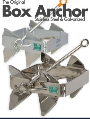

There are some very very wacky anchor designs such as the box anchor (see the first photo below) that claims only a 40 lb model is fine for a 70 foot yacht and a scope of only 2:1 is needed with all rope rode.
Why is it that the worse the anchor, the more outlandish the manufacturer’s claims?

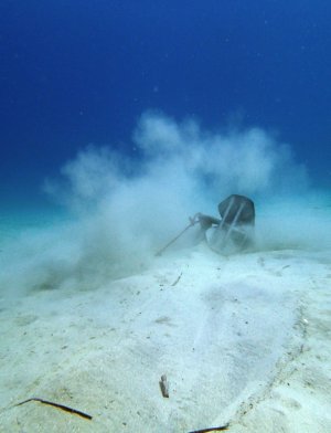

But considering more mainstream models, for overall worst performance my vote would go to some of the convex plow designs that have attempted to copy the Delta, but have managed to make something worse.
Below is an example. This is a Shark anchor managing to slowly drag backwards (notice the clouds of sand) without ever setting in a nice hard sand substrate. This is in only 20 knots of wind with a 4:1 scope.

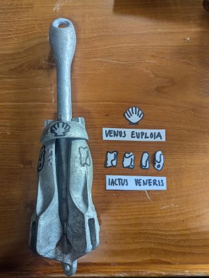

For the dinghy, in rocks they work very well, to the point that they are often hard/impossible to recover. A number of times we have had to dive to free it. I agree in sand they are pretty rubbish.
We also carry a grapnel for our dinghy. Holding in sand is well demonstrated by the one time we forgot to retrieve the anchor. We carried the boat some twenty meters into the water, not even noticing we were dragging the anchor behind 🤦‍♂️
So, inspired by this thread we now invoke the roman gods to ensure better holding:

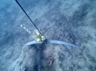

Sailors are allowed to be superstitious.
One Christmas we tied some decorations to our Mantus anchor in order to please Saint Nicholas (who is also the patron saint of sailors).
I am not sure it helped, but we didn’t drag despite some wild weather that we experienced that winter in the Mediterranean.

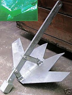

To set the ball rolling, I nominate the poor copy, cheap steel Danforth - of which there are thousands rusting away remorselessly in bilges nationwide.
I would like one of your Shark anchors, which is able to "drag backwards". 😀

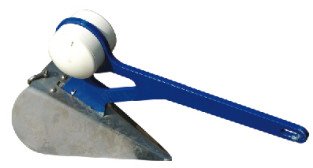

It was probably in the 60's an anchor looking a bit like a danforth was being advertised as a kedge to use when the boat ran aground. The idea being that it could be launched from the stern and would glide away from the boat, settling on the sea bed far enough away to be used to haul the boat off.
However, the prize for the worse anchor must surely go to YM's water ballasted anchor that they promoted in an April edition, again probably in the 60's but may be more recent. It would suit those who are enthusiastic about light weight anchors as it could be stowed dry, and only filled with water ballast when deployed.
It was called the Flook anchor. It was quite popular in Australia at one stage:
"Flook" anchor maybe (?), rings a bell about this underwater gliding thing
:D one second late to noelex
