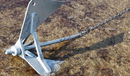

I’ve got a Trefoil - Bruce copy. It’s crap, but not, by far the worst.
Agreed. The Bruce copies are often very poor, but the Trefoil at least makes some attempt at reproducing the geometry of the original Bruce.
Here is a photo of a Trefoil branded model I came across. It has not at this stage had enough setting force to properly assess its performance, but at least it has managed to roll upright and is starting to engage in a light weed substrate.

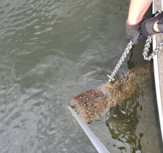

Our boat came with a stainless Bruce clone. Here's my only photo of it in action, providing us with a steady supply of waterlogged lumber:
We still keep it as a stern anchor, because for Scandinavian mooring probably an Egyptian carved rock would work as well. Usually you anchor in a place with zero wind and waves.
