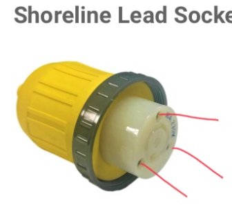

Of course DIY kicks in (I’m in Spain) but I can’t get the shroud off the Marinco 16A plug to take a look. I’m doomed. Can anyone here help with at least this bit?

Build up the dia of the 16 A lead with wrapping insulation tape so it fits tight enough to be gripped in the larger 32 plug , termination jaws that grip it as it comes out of the plug .
To open from memory ( I open mine once a yr to ck the terminals ) undo the screw in the centre , there may be two ,of the white part of the plug .Once loose the yellow cover just slides back exposing the connectors and the jaws that hold against pulling .
Alternatively if you don’t like fatting up the 16 A wire to fit 32 plug jaws with tape ……cut some 1/2 pipes of outer insulation to place round and effectively fatten up the dia to fit .Consider gluing them on once the dia is correct .
