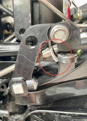

I have a pal with a small canal cruiser fitted with a Suzuki 9.9 4-t outboard. It is well overpowered for the boat but that’s another issue.
The engine is removed and taken to an approved service agent when required. Like many boats, it’s lightly used, only a small number of hours per year.
Recently it’s become near impossible to take out of forward gear using the cable control box. He recently broke the plastic cable end fitting by excess force. Now once it’s in forward gear, I’ve had to remove the cable end fitting and use a fair amount of force to push the gear select lever into neutral.
Any suggestions, please?
I know very little about outboards (I have the ubiquitous Tohatsu 2.5 2-t for my tender) but I’ve been thinking about gearbox oil, especially slippery additives?
A few weeks ago the prop caught a Marks & Spencer woolly jumper (that had been thrown into the canal). There’s no excessive vibration so I don’t think this is related but worth mentioning.
Many thanks in advance.
