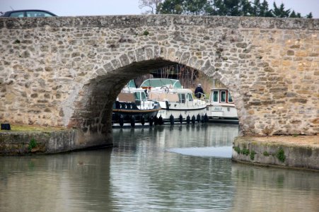

My first experience in France was on a traditional British steel hulled canal boat and the eclusiers always put you first as there is no chance of the plastic boats damaging you whereas the reverse is not true. Since then been back three times in plastic boats without problems but always stay clear of the really big LeBoats which always seem to have the worst drivers. And, yes, air draft and width is an issue particularly on Canal du Midi. I checked all the boats I looked at against this (Capestang)
