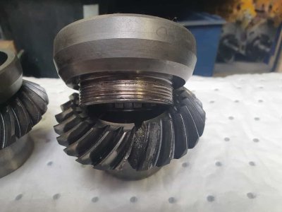

A friend has had an issue with a VP MSA4 gearbox that has one broken gear. Apart from the break, there doesn't look to be excessive wear, so i wonder what might have caused the problem. I do have a suspicion, has anyone seen something similar ?

Flaw in the metal, wrong hardening, bottom strike(but these have shock absorbing prop hubs?). Without a lab test it's all guessing.

This was probably the result of hitting the bottom. It took a few weeks before it actually failed.

Thanks everyone for the replies. The gearbox has already been rebuilt, i was really just looking for opinions as to why the gear has broken. The gearbox people said it was just wear, but it doesn't look worn on the other teeth. I wondered if it might have been caused by picking a line up on the prop.

Needs a real shock to do that ?
Did help somebody else to sort another drive shaft breaking in exactly the same place as mine, although in his case the break was compound .
In both cases we were able to buy new shafts from VP and with expedited delivery they were delivered within 48 hours and were back in the boats a day later.
One boat was P35, the other a Fairline Corniche 31 of similar vintage.
He always steadfastly claimed he never hit anything.
