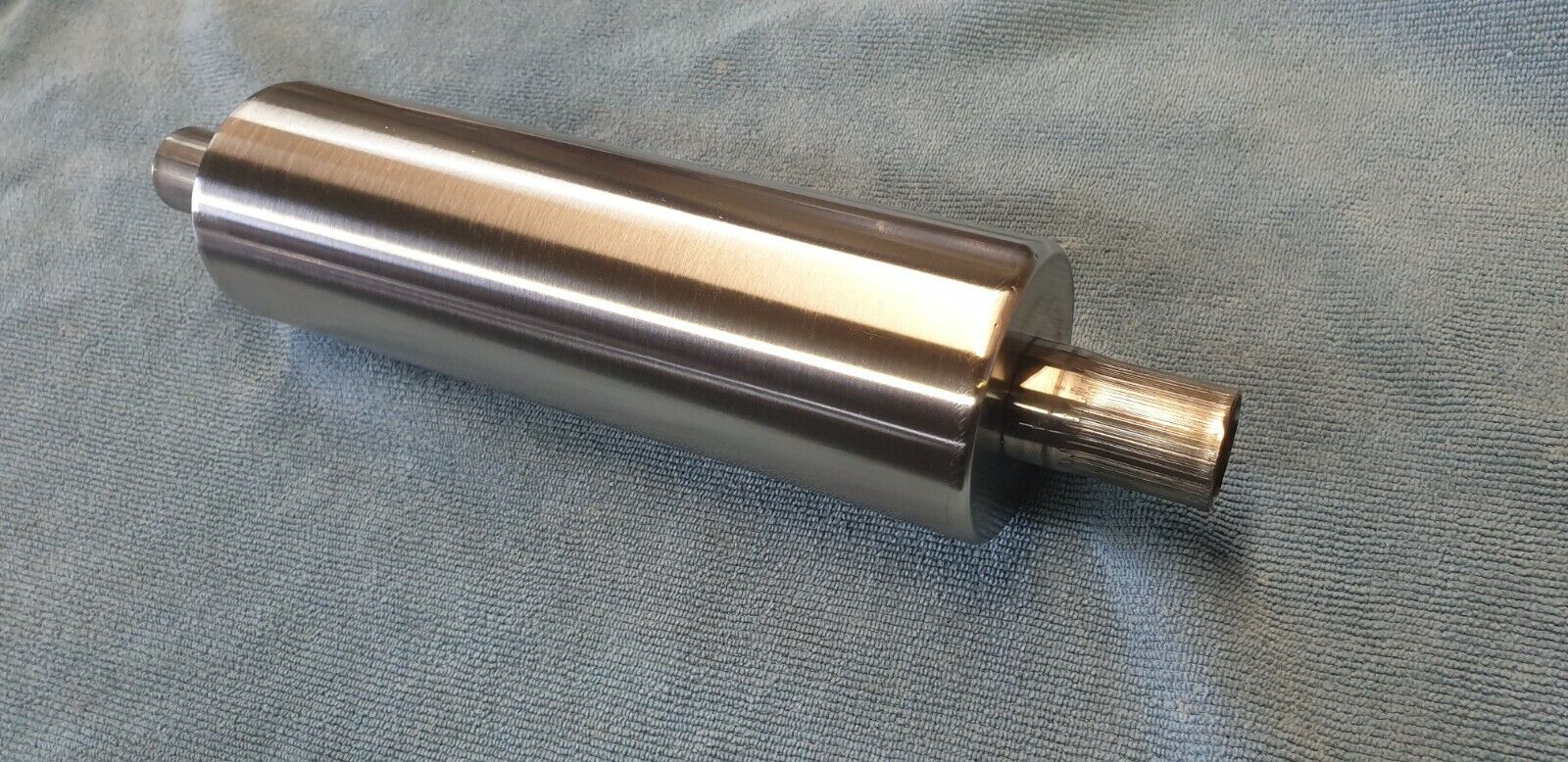

I fitted one on my Contessa 32 last year in the Aft locker. No silencer and its quite outside. I used a SS flexible pipe for the exhaust lagged in the red stuff. It gets extremely hot so I re routed wiring and anything that could come in to contact with exhaust. My batteries are maintained by only a 50 watt panel and I have no problems running the heater for several days none stop in winter. I did not fit an air intake pipe and was not too fussed about ventilation as I believed the heater was so far away in the stearn. big mistake. Ive now fitted an air intake pipe from a very well ventilated source. Its also important to have ventilation for the cabin.
