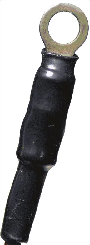

How can it corrode when the terminal is insulated properly? Of course tinned wire can corrode too.
That should do it but I usually shrink sleeve over the first shrink layer. My corroded wires had not been shrink covered and ran behind headlinings.
Electrical insulation does not equal waterproofing. The sleeved terminal you have show is not waterproof. It will corrode under the sleeving.
Don't tell me a heat shrink terminal is not waterproof?
Well tinned wire can corrode too in those circumstances if they get wet.:)
