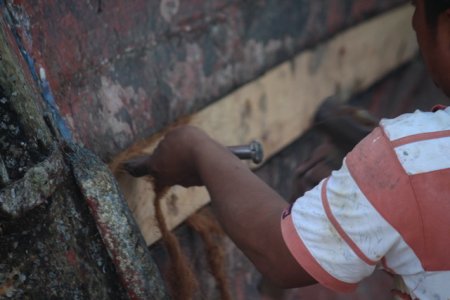

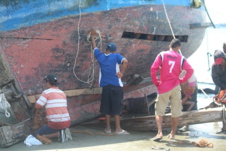

This is how they do it, between the tides, in Manta (the largest tuna port in the world?) for the local tuna boats. Most of the tuna landed is from large Spanish (crewed and owned) boats considerably bigger and more sophisticated than this local example.
Jonathan
