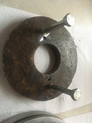

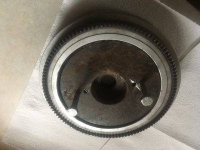

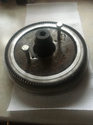

I should have mentioned that the flywheel fits on a tapered shaft.
I found a disc the right size. The two bolts should project far engough and it does not matter if they bend.
