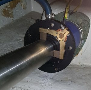

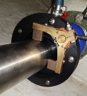

To be fair to Tides, our Princess was fitted with an earlier model.
The newer ones that I have replaced are slightly different.
The new ones appear to have slightly bigger front ring but they are fitted with screws rather than allen bolts
This is our old one
And this is the new one - very similar - but definitely different
