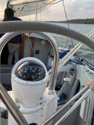

Hi,
This is something that has puzzled me for years: why is the engine throttle on older sailing yachts usually positioned on the floor or half-way up the wheel pedestal? I recently sailed on a Beneteau 37 which had the throttle half-way up the pedestal and only reachable by stooping and putting your arm through the wheel unless you stood side-ways on which was not always the best place to be. It seems perverse - the sailing world is normally so focussed on practicality. Modern yachts seem to position it alongside the instruments where it's easily accessible in the same way as on power yachts.
Is there a safety reason, perhaps? Maybe to help prevent sheet snagging? Or is it just that older yachts were designed by sailors/boat builders who had no formal design training so didn't see the importance of ergonomics (or even common sense)?
