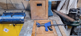

One of the jobs is to removing the rotten parts from the many cupboard doors from the interior of Chance which were taken off her earlier in the restoration. Many of the parts were very wet and now have had time to dry out.
Now that the parts are dried out it can be seen what is rotten and what was just wet.

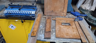

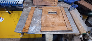

This galley cupboard door was one that was both wet and rotten and now as dried out we can see what is rotten and how to remove the parts that are rotten and keep the parts that have dried out and will only need sanding and staining and varnishing before they are refitted later on in the restoration.

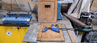

The first job we have to do is carefully dismantle the frame of the door off the centre panel using a Squeezy clamp setup in reverse where the feet are set to push parts apart from each other rather than to clamp them together.
Once the first part is apart from the centre panel then you repeat the process on the other parts until the two parts you need off the rest of the door are done
Then look for some mahogany that is a close match to the original mahogany and then thickness it to the correct size

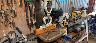

Then set up the mortise drill on the large pillar drill to make the mortises
When Chance was build they may have these drills, however, if they did not have these mortise drills, they would have been done by hand with a twist drill bit and a mortise chisel and a wooden mallet and would take a lot more time than using this mortise drill setup on the pillar drill.
The business end of the mortise cutter

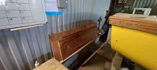

These two doors are off Chance and they are in need of a complete rebuilding as they are rotten in too many places to make repair the way to go

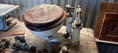

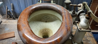

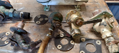

One of the jobs is to restore the original Baby Blakes toilet back to working condition so it can go back in the aft heads compartment when that part of the boat is refitted back to its original specification
Although the toilet is in a bit of a dirty condition, it will soon clean up and once again come clean and ready fro years of further use.

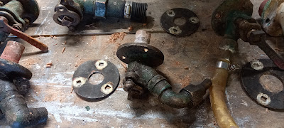

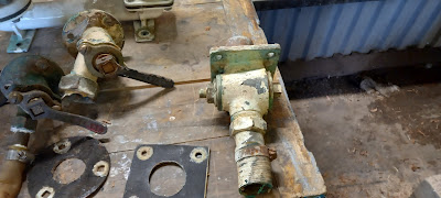

This single large bore skin fitting is unlike any other skin fitting in the boat and appears to have been custom made for the boat.
Some of the skin fitting were able to be removed with their original backing plate and are in good condition and will only need cleaning up and used again, other backing plate were in a poor condition due to corrosion.
The two skin fittings in this photo are the aft heads toilet skin fittings and are in good condition.

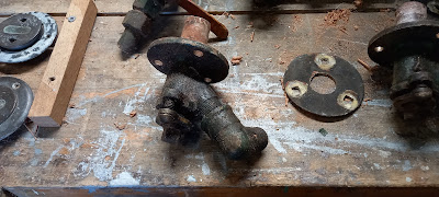

The aft heads compartment sink skin fitting
This is the fore cabin sink out let skin fitting
These are the two fore cabin toilet skin fittings
At sometime in the past the fore cabin sink and toilet were removed and the skin fittings were locked closed and left in position. As part of the restoration the fore cabin toilet and sink will be refitted as they were originally fitted when Chance was commissioned and launched in 1948.

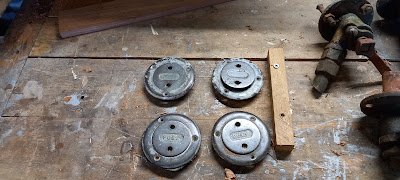

The original deck fillers for the fuel and water tanks which after they have been restored will be refitted to the restored teak deck of Chance.

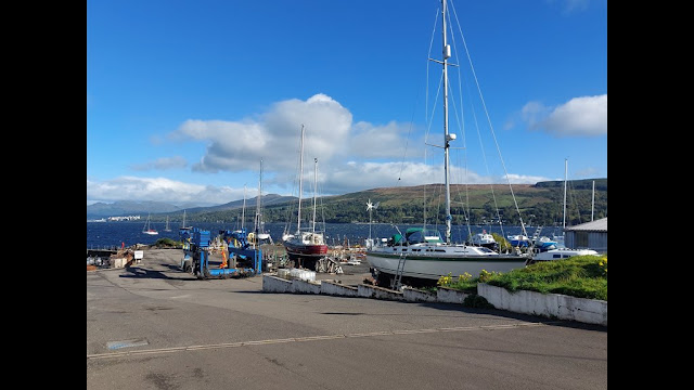

This is the Scottish village from which Chance was commissioned and launched back in 1948 and it is still boat building to this day
this is the onsite sawmill that the logs were cut for Chances' hull and many more before and since. Although it is now the yards mast storage as the timber now is brought in pre-cut these days.
This is the site of the old shed in which Chance was build in 1948 and many other smaller James Silvers. A the Yard Manager said this shed was build to built the James Silvers up to 50ft and the larger sheds on the site were to built the larger Silvers.
The loch where Chance would have first sailed on her commissioning trials and where Chance would have spent her first year before setting off on her adventures through her different owners down the years.

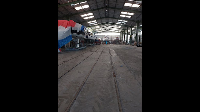

Inside the small boatbuilding shed at Silver's boatyard, which the same boatyard that Chance wa build and launched from in 1948
The shed is large by todays standards, however, when boats like Chance was being build there was a number of boats build at the same time and so the space would be full of boats and men building they at the same time
The railway tracks in the ground were from the time when the boats were moved around the shed and moved down to the waters edge and launched down the slipways, which the Boatyard manager Duncan said was ten of them at one time, so was the amount of boats being build at the same time.

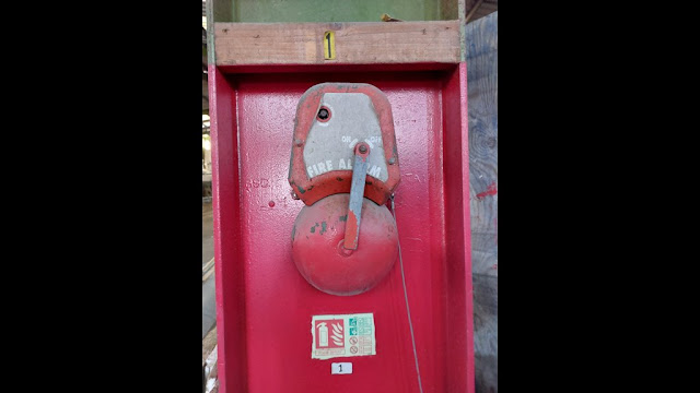

A throwback to older times with a classic fire alarm
