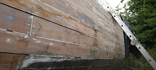

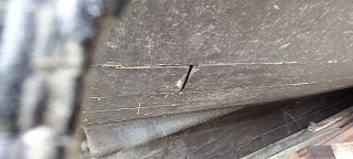

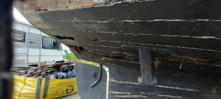

Planning for the next trip to Woodplumpton to start on the hull repairs
This is going to be our first place we are going to tackle, the aft cabin on the starboard side with the worse area of rib repairs that is needed to be renewed in the boat. The area where there are so many short or doubled or sistered ribs and the place where the shape of the hull is not the shape it should be. It is also the area where there are a number of planks need replacing in the underside of the hull.
As can be seen in this photo in the top left hand corner, there a number of planks that need renewing.. This will need the starboard "A" bracket and the starboard propeller stern tube log removing to get rid of the rotten planks and get back to good planking. Once the planking is renewed then the "A" Bracket and Stern tube log will be refitted and a new oak Stern Tube Log made to replace the old Stern Tube log.
Once this area of the hull is sorted and re-ribbed , then we can move along the hull to the next area of the hull that need ribs and planking replacing . So this is what we will be doing over the next few months as we get the hull strong enough to be moved to Essex.

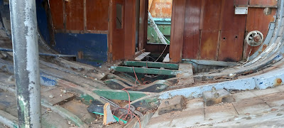

This is an update to let you all know what we have been up to over the past few weeks and month. We have finally got the engine room cleared of all the water and fuel tanks and have got to the see the condition of the hull and the ribs in the engine bay. As we had feared the broken ribs were behind the water and fuel tanks. We had thought that may well be the case and were not really surprised to find that they were in that condition.
One thing that did happen when we removed the water and fuel tanks was that the side deck collapsed and had to be shored up until we can make repairs to the deck beams and beam shelf to get the deck back up to their correct height again.
The fuel tanks were rusted through on the tops of the tanks and were badly rusted at the bottom so it was decided that the best course of action was to remove the tanks and in the future have new stainless steel water and fuel tanks made to the same pattern as the original tanks. That way keep the same weight in fuel and water to maintain the correct trim.

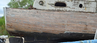

It has been a fortnight since we have been up at Woodplumpton and it is now time to go up to Woodplumpton again for a weeks work on Chance.
Now that all but the masts and booms are now back at my workshop it is time to make a start on the repairs and restoration of the hull planking and ribs in the boat.
We have investigated the boat from stem to stern and have found that Chance is in need of a lot of ribs to be removed and replaced along her length. Surprising the ribs forward on the main cabin appear to be in good order apart from a few where bulkheads have crossed over them and made them rotten through fresh water rotting the bullhead and in turn rotting the rib.
The most damage to the ribs is amidships down both port and starboard side. The starboard side being the worse affected with the breaks in the ribs going all the way to the transom. On the starboard side they were doubled and in some cases sistered rather than replace the whole rib and not make the planking look like a pin cushion. The port side faired a little better and the broken ribs end in the aft master cabin heads.
The planking is another pr4oblem, as over the years, the planking as been replaced with short lengths to just remove the rotten wood at the time with no regard to the strength of the hull, which is now in a poor condition and long lengths are going to have to be replaced in order to return the strength back into the construction of the hull and get the hull back into the correct shape which has been lost over the years through repairs.
So it has been decided to make a start at the worse affect part of the hull the starboard quarter and work our way a long the hull until we go round the hull to the port quarter. While one of the working party tackles the transom and the framework that it is made from. From research done the transom was made up off the boat in a jig and the fitted to the aft end of the deadwood. once it was in place the planks were fixed to the transom after the bevels were cut and shaped on the oak frame work around the edge of the transom.
Unlike some modern boatbuilders with their modern ideas of how to re-plank a hull I am going to do the re-planking using the old time served method of removing every other plank, that way keeping the shape of the hull and not letting it distraught out of shape. I do not know where this idea that you can deskin a boat and think it is not going to go out of shape. The only way it would not happen is that as the old planks were coming off and a boatbuilder was cutting and shaping the planks as fast as they were coming off and refixing them with the correct fixings . In the case of Chance Copper nails and roves on the ribs and bronze woodscrews on the frames. I would love to see this method done by a single boat builder doing a restoration project such has Chance. I do believe only the major boatyard would de-skin a hull and refit a new hull if they had a double gang of boat builders doing one side each. Screwing new planks on to old ribs and frames is not only a bad practice, but a practice that is in my mind a bodge and a practice that should be stopped before it becoming the standard by which boats are repaired.
So over the next few months you will see how a hull should be restored using traditional methods.

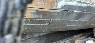

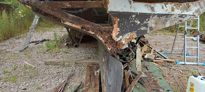

Removing the covering boards to uncover a can of worms and poor repairs from the past.
The port side of the side deck and aft deck is original as the position of the deck fittings are still in place
The positions of the side davits and the aft davits and the aft cleats are clearly seen in the deck
There is a large hole in the deck as a repair was started and never finished
The starboard side deck was repaired but never mirror to look like the port side deck which will be done this time
The aft end of the
side deck and on to the aft deck is a lodging deck which is in place but not fixed to the beam shelf
In the past the beam shelf was replaced but never fixed in place correctly and someone had done a poor repair to the deck and did not take the time to make sure to mirror the teak deck planking to be the same as the port side.
The beam shelf is rotten in a number of places and will have to be replaced along it full length and so is the top plank. Also the short deck beams will have to be replaced as these have been hacked about with in the previous repair
So it is going to be fun renewing the poor workmanship of a previous repair

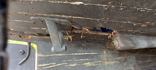

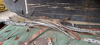

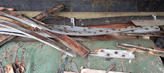

These are all the ribs from the aft cabin area,some are just short ribs, others are dry laminated ribs, that is to say they were steamed into position and not glued together before they were nailed in position.
They were different widths and thickness as well. I will take measurements off the original size and steam new ribs into position using the original specification.
The starboard side of the aft cabin with the ribs removed, now the cleaning up of the hull planking and hole filling of the holes that will not be reused
The hull planking looks like a pin cushion with all the nails removed
A lot of the planking in this part of the hull is going to have to be replaced as it is rotten and made up of short lengths

Now that tanks are out it is possible to remove all the old tank support bracket and clean the years of dirt that had collected in the engine bay
The first time oin over 70 years the bottom of the bilge in the engine bay as seen the light of day and it is good order after all the neglect it as had over the 20 plus years until we came to Chance rescue
All that is needed now is the old bilge ump and water pipes to be removed and then the cleaning can start

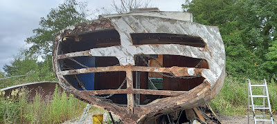

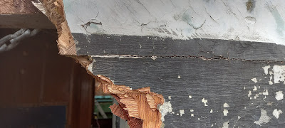

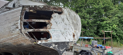

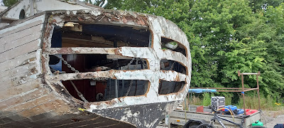

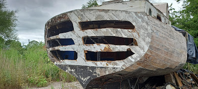

Starting on the transom and finding out the major repairs needed to be done before any work can be done to the planking
The way I first saw Chance a year ago and a job I was not looking forward to doing
First job was to cut out the sections of the transom between the beams running athwartships and then remove the bit fixed to the beams
The first of the many odd repairs done to the transom. The transom covered up the end grain of the planks with a thin layer of plywood
The frames are well rotten and need replacing first before any work can start on any part of the boat
The upper part of the transom was made up of diagonal plywood, however, the bottom part was made up of athwartships layers of plywood
One bit if you can see it, is that the starboard side as dropped and the the sheer line shows that it as happened, so the starboard side is going to have to be propped up back into position until the sheer line back in the correct position
With the ribs out of the starboard side in the aft cabin and with careful propping the shape should come back in the starboard side and the transom will be the correct shape once more
