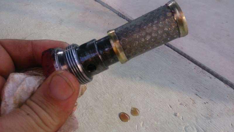

Just a thought have you removed the oil strainer and checked this is clean - large plug at bottom of box below the oil pump. This will drain the oil, so collect this and check for any metallic debris.
Your box is certainly very similar to the MG502.
I think I'll just do that and remove the stbrd selector and place it on the port box after examining the valve underneath it that is.
Oil strainer is after the suction pipe from the sump to the pump and just before the pump. Big 32mm socket to remove it, yes done it forgotten to post pics on the thread here it is:

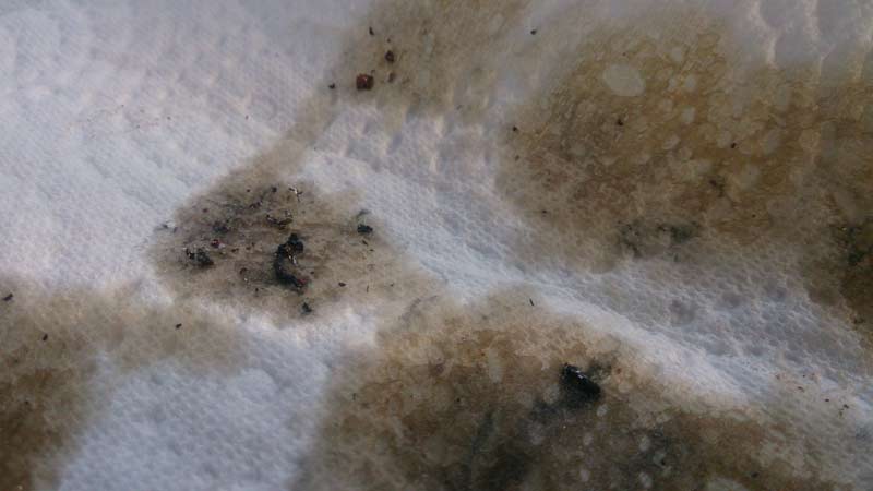

you can see some debris on the towel
all the bits are magnetic and are in the following pic stuck on the two magnets of my tape measure (just to give the size of the debris):
I consider that OKish, haven't got a clue when the oil was last changed, will do so.

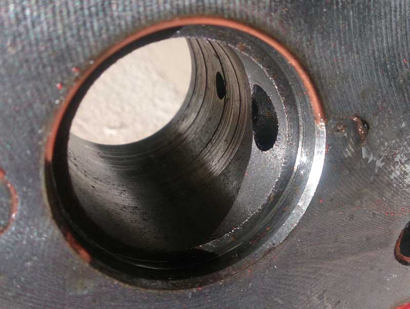

Next step was to remove the diverter assembly. A few more allen and hex M10 bolts a bit of tapping and off it came (heavy thing!)
Also looks nice and clean but needs careful checking on better lighting conditions and after some thorough cleaning.

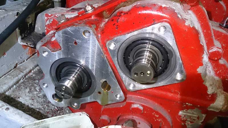

Assuming the twindisk MG502 is not inverted to the TM170/880, the axle that does the port box fwrd movement is the one that the pump is mounted. It's the longest route for the oil that starts from there, goes to the cooler comes back to the diverter assembly on the wrong side of it (on top of the reverse axle) and then goes to the diverter and to the axle. Anyway, a bit of blowing will show if the thing works or not.

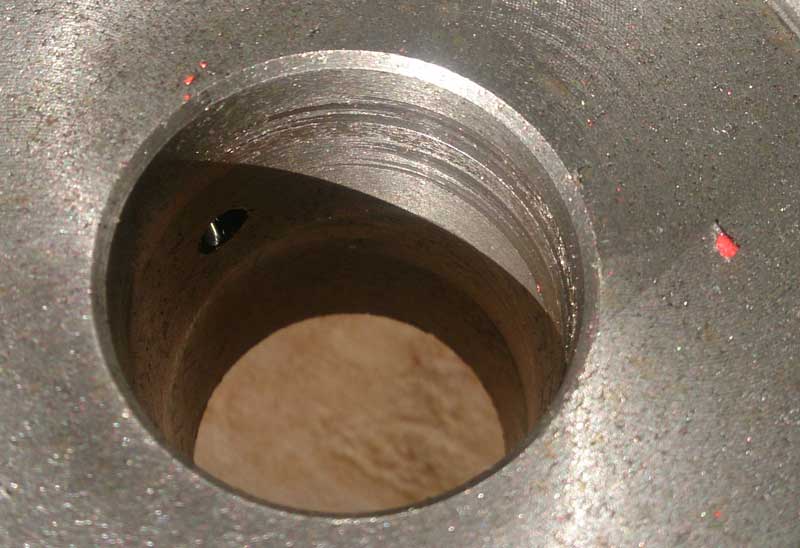

and a few pics of the box sans diverter assembly:
and the black sort of deposits on the two faceplaces of the diverter assembly, no debris, just black soot (if you can call it that):

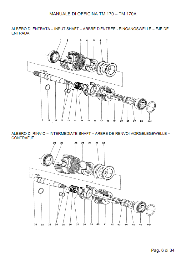

and a final post for me before getting back to "real" work, to note that on the service manual they show two seal rings on the narrower first and third groove of the axle, second groove is where the oil hole lives, which were not there on disassembly.
Totally dissintegrated in 600h?
Missing or changed from the manual setup and stopped using them?
I also wonder how a (silicone I presume) seal ring can withstand the temps and constant wearing on the turning axle.
Tempted to get two silicone seals and try it on tbh.
Items 11 on top assembly and 34 on lower:
cheers
