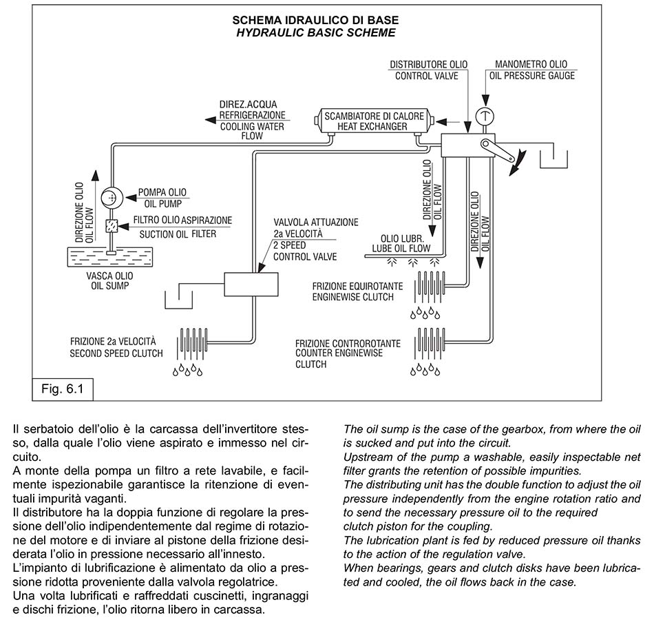

I do have gauges, and even if for some reason my memory doesn't behave like good red wines (which get better over time! :D), I can confirm you that it does NOT change a lot. Last summer, I kept a constant eye on all instruments during the delivery trip, and g/box pressure has always been the most constant parameter: 7 to 8 bar in neutral, and 23 to 24 bar with clutch engaged (in this respect, the values obviously change a lot, but surely that's not what you meant).
Btw, the (analogue) gauges are not accurate enough to distinguish differences of 1 bar, but I read in the ZF manual that these are the rated pressures, and the gauges were reasonably consistent with them.
Below is a manual abstract, which explains that the oil distributor is designed to keep the pressure constant regardless of rpm.
It's related to ZF 350 g/boxes, so surely different from yours, but I would think that the general principles still stand.
