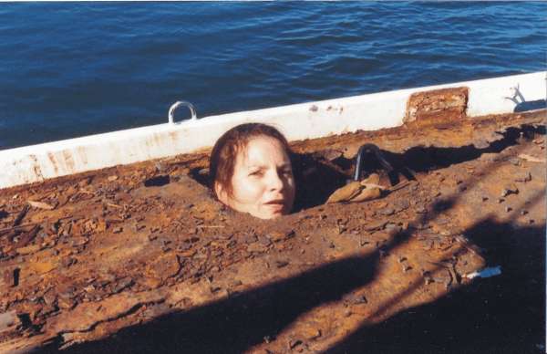

I would have written it all off to experience, but this guy completed the restoration. This might go some way to explaining why used steel boats are so cheap.
What a nightmare, and seriously, rotted balsa core or this ... same ballpark IMHO.
https://www.thecoastalpassage.com/rust.html
Interestingly it echoes very simple advice hidden away in this bickerfest of a thread many times for avoiding steel boat calamities. Strong reason for avoiding many factory built boats and going for a well designed and built self build.
