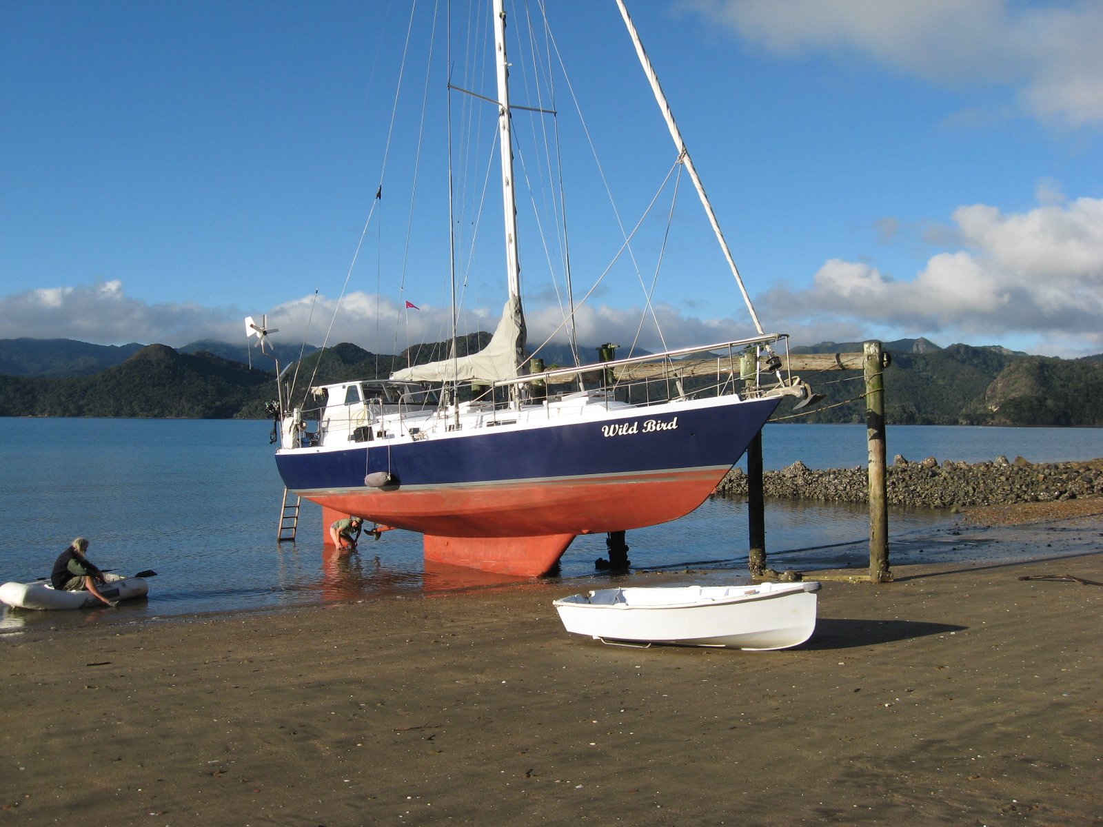

Colin Lowe, who used to write for Yachting Monthly, completed a circumnavigation in Wild Bird a 12m Ganley (extended Timerider IIRC) with his family. It certainly sailed well - it had to, Colin didn't like using the engine & I remember him towing, under full sail, a broken down yacht up the Malacca Straits.
I'm not a fan of steel boats but I'd be happy to have a Ganley yacht like Wild Bird.
Here's a pic - sorry it's so big but it's linked to his blog so I can't do anything about it :eek:.

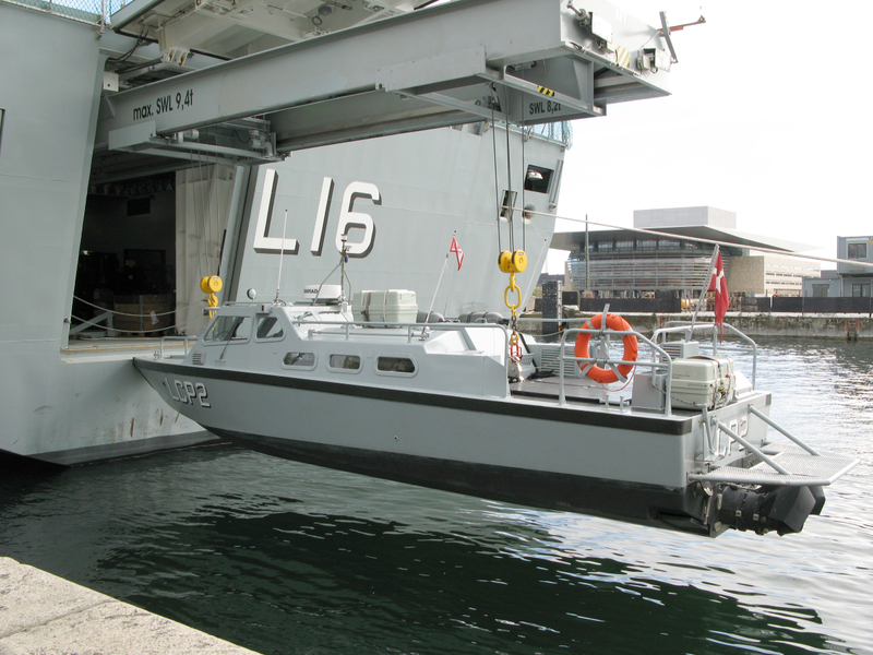

LCP and SAR
Well, fibreglass stops making sense as you get bigger, so nobody's going to make a container ship out of it. But I believe GRP is not uncommon among smaller fishing boats, and some of the lifeboats use it too.
Pete
Current vessels
Glass/Carbon, several SAR vessels too. In the eighties the Royal Danish Navy built the Standard Flex (STANFLEX) vessels of GRP too (Danyard) and they're 450 tonnes, however are now sailing in Lithauania.
