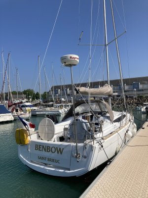

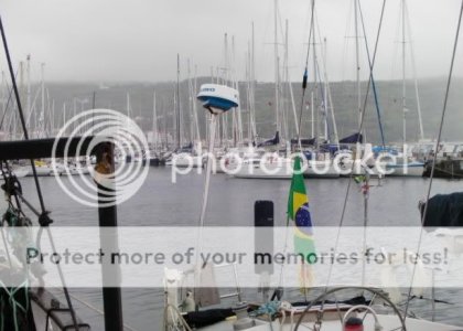

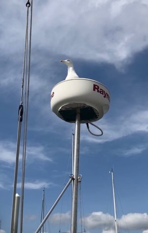

On my own boat it was on a pole on the starboard quarter. Nary a wobble, the installation was extremely solid. Also a convenient spot for shitehawks to keep an eye on you when lunching in the cockpit.IMG_9201.jpegIMG_6342.jpeg
