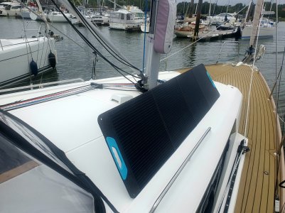

I am new to solar panels but impressed with a Renology 200W folding panel and Victron 75/15 MPPT controller that can top up my house batteries for a budget under £300 inc cables.
First attempt saw it pushing 10A into the batteries with the panel pointing at late afternoon sun in the Hamble.

That portable panel is interesting. I had a Victron MPPT installed as part of our upgrades as it was easier/cheaper to do then than add it later but am struggling to find a place where a permanent panel would fit
It sits nicely on the coachroof with it's fold out legs. Just working out other methods to angle it towards the sun.
I only bought it to recharge the ePropulsion battery on an ad hoc basis but suggestions here convinced me to use any spare energy for the house battery. For an additional cost of £45, I fitted the Victron MPPT.
