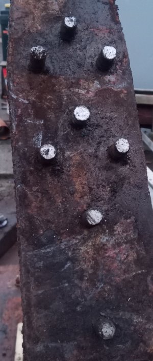

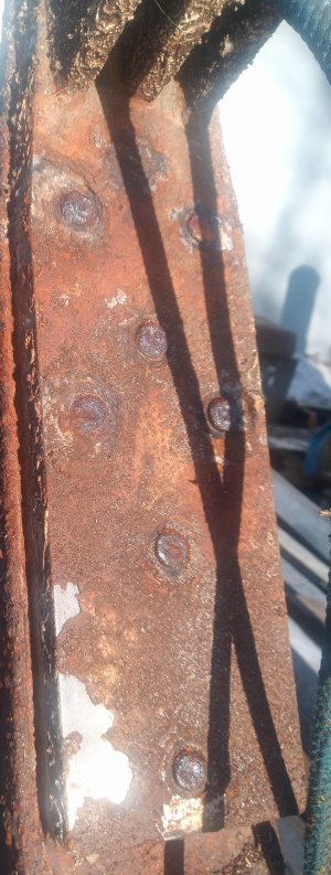

A stainless steel bracket was fitted at some stage, this bracket is what stops the keel dropping too far and anchors the lines which are used to pull it back up. It is submerged when the keel is down.
The bracket is bolted to the top of the keel with 9 m14 mild steel bolts complete with stainless spring washers. The heads of these bolts had completely disappeared.
What I do not understand is that there was no corrosion between the bracket and the keel. I am now wondering what to use to refit?

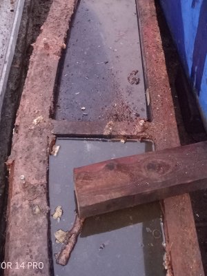

Southerly left voids in the castings. These are then partly filled with foam insulation boards. When I took the keel and plate off These voids were filled with soggy insulation and a few liters of foul smelling seawater. I am thinking that I should fill these fully, ideally with something that does not take up water such as a resin or expanding foam.. or even sand and cement...

Photos show bracket and headless bolts and voids in the grounding plate.

Suspect the corrosion on the bolt heads is just rust. Stainless bolts into cast iron is quite normal for keels. The stainless bracket is OK so don't see any reason why stainless bolts and washers set in plenty of sealer should suffer any corrosion.
