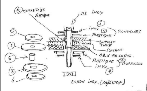

These are the mechanical components used by good light alloy hull boatyards for through deck bolts. 1-4 steel washers, 2-3 nylon/pvc washers, 5 pvc sleeve around non threaded part of bolt, "Isolant" is plastic material between stainless fitting and Al deck plate. Other compounds/pastes added if necessary.
